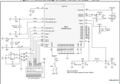

Sorry for the late responce! It seems my pcb is working correctly in release mode => when I program the uC. So I suppose the problem is in the selected debuger type. I am using ST-Link as a tool and I connected every jtag related pin to the connector. I didn`t know what to expect so I prepared the pcb for everything. I have TRST, TDI, SWDIO, TCK, TDO and NRST connected to ST-link. In the .ioc I have selected JTAG(5 pins). Is that correct? What should I use for this controller?
Thanks!
2025-02-25 4:48 AM
Please refer to the AN4555 / Figure 14. Reference design STM32L4 Series / STM32L4+ Series:
And use Serial Wire mode.
