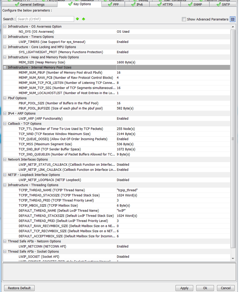

I am adding a print screen of my cubeMX lwip key options tab.
Can you please take a look?

2017-12-08 4:11 PM
Hey ho Marina.
You send 1024 Bytes (netconn_write) but you have a tiny segment size of 536 bytes? Pump it up.
Some parameters should be tweaked to have a better performance.
It's also a good idea to turn on LWIP_DEBUG to see what's going on with the traffic.
Go to the Debug tab and turn on: LWIP_DBG_TYPES_ON, TCP_DEBUG, TCP_OUTPUT_DEBUG, TCPIP_DEBUG.

Like that:
static
void
tcp_thread(
void
*arg)
/* Create a new connection identifier. */
/* Bind connection to well known port number 7. */
conn = netconn_new_with_callback(
NETCONN_TCP
, callbackConnection);
err =
netconn_bind
(conn, IP_ADDR_ANY,80);LWIP_ERROR(
tcpecho
: invalidconn
', (conn != NULL),
return
/* Tell connection to go into listening mode. */
netconn_listen(conn);
while
(1) {
/* Grab new connection. */
err = netconn_accept(conn, &newconn);
printf
('accepted new connection %p\n',newconn
/* Process the new connection. */
if
(err ==
ERR_OK
for
int
i= 0; i< 256; i++)
buffFloat[i] = 1.0*i;
uint32_t
val;
while
(1)
err = netconn_write(newconn, buffFloat, 1024, NETCONN_NOCOPY);
xTaskNotifyWait(0x00, ULONG_MAX, &val ,portMAX_DELAY);
err = netconn_write(newconn, buffFloat, 1024 , NETCONN_NOCOPY);
/* Close connection and discard connection identifier. */
netconn_close(newconn);
netconn_delete(newconn);
Thanks for the help with the debug flags and statistics, I did not notice them before!
Best regards,
Marina
