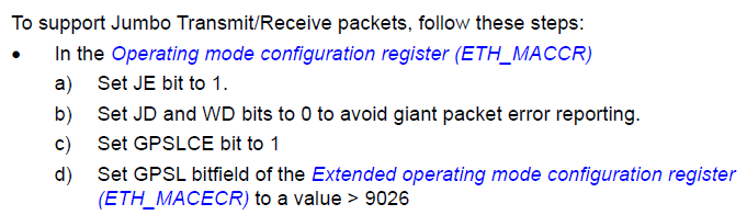

I want to use jumbo frames to avoid IP fragmentation while streaming audio via UDP. So, no jumbo frames have to be received. I only care about transmitting.
Below is my StartDefaultTask function, which is called in main(). Normal transmissions under 1500bytes MTU work fine when MAX_UDP_PAYLOAD_SIZE is adjusted.
I understand work needs to be done. I've tried changing buffer sizes and adjusting values in low_level_init(), but I'm unable to get it to work.

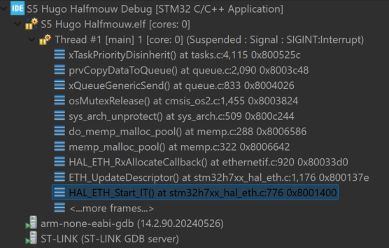

Currently, with ^^ at 2000bytes the debugger ends up here:
