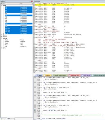

2025-09-02 3:46 AM
Thank you for your answer; it helped me make progress.
The code execution advanced further after I disabled the System Viewer window. However, it now gets stuck while comparing the values of the MR0 and MR8 registers.
Does this information from the debugger indicate a real issue, or could it just be a debugging artifact?
Furthermore, could displaying the MR register values in the Call Stack and Locals windows somehow be influencing their actual values?

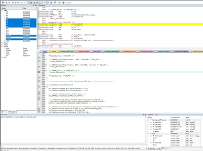

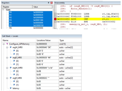

2025-09-03 7:04 AM
See below comments
1. Where is the memcpy() of line 249 disassembled?
There should be something like "B 0xXXXXXXXX memcpy" right after the 0x0800065A as in 0x0800064A, then RET.
2. Run until 0x08000658 CMP instruction, so that you know the exact r0 and r1 value
Determine which is regR_MR8[0] and which is regW_MR8[0]. Compare them with those in call stack locals at bottom right.
3. Which is the right value you want? 0x44, 0x3C, or something else?
I saw regR_MR0[0] and regW_MR0[0] are different, maybe the XSPI timing is totally misconfigured?
2025-09-04 7:36 AM
Thank you for helping me figure this out.
1. For the first question - pic1.
2. For the second question- pic2.
