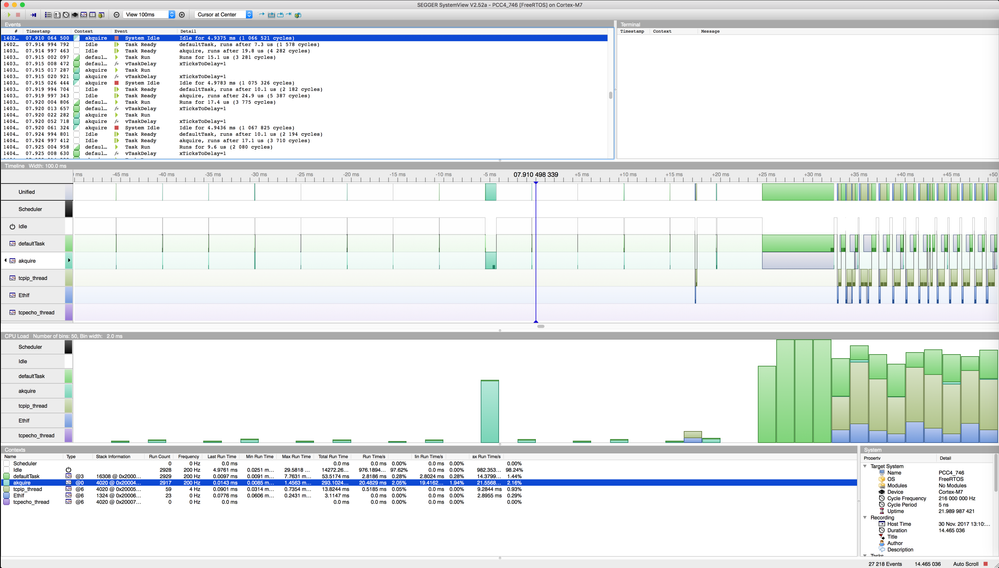

I use both SystemView and Jscope extensively. Both on a Linux host.
You'll need to match the patch with the version of FreeRTOS. V9 is current and the V9 patch is available as well.
What issues are you having in particular?
I've included my entire FreeRTOS source that has already been patched.
