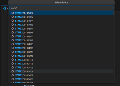

5) Then when it comes to device selection unable to find STM32H7 Series, eval board numbers in the list.
Note : STMCUFinder path, cubemx paths configured . please check below images

2025-10-24 5:46 AM
@Jagan1
Please let's skip this quick pick and focus on the red text field. Has any device completion appeared when you start typing STM32...?

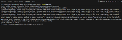

If not, could you please try running the following command in the VSCode integrated terminal:
cube pack syncDoes the process complete successfully? If not, please share the trace.
2025-10-24 5:53 AM - edited 2025-10-24 6:10 AM

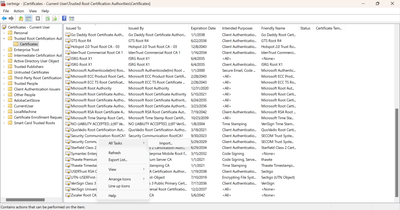

capture picked from the internet
You could try export them (Zscaler*) in base-64 encoded X.509 format, and gather all exported files into a .crt file respecting this kind of format:

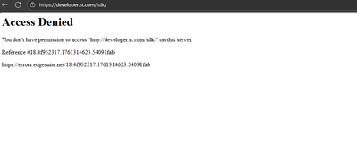

2025-10-24 7:05 AM
2025-10-24 7:12 AM
Ok, it is denied but at least you have the lock meaning connection is secured, so you can proceed with the rest of my previous message.
