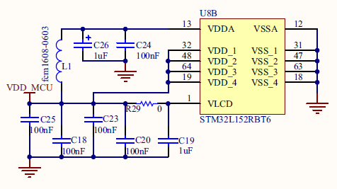

The extra bit is troubling, I guess you'd want to suspect speed/voltage and prefetch. The prefetch path is one of the critical ones, and low voltages will slow things down, including the flash. Do you have some bulk capacitance close into the supply pins, along with the decoupling caps? This is from the L1-DISCO, C19 is not a tant, and I might look to get a 1uF or 2.2uF close in on the VDD side, especially if the RF TX pulls a lot of instantaneous current, and you'd want it on the chip side of the inductor/choke2014-01-24 7:41 AM

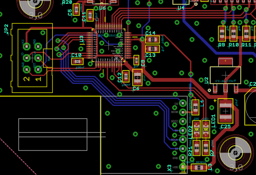

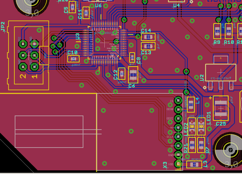

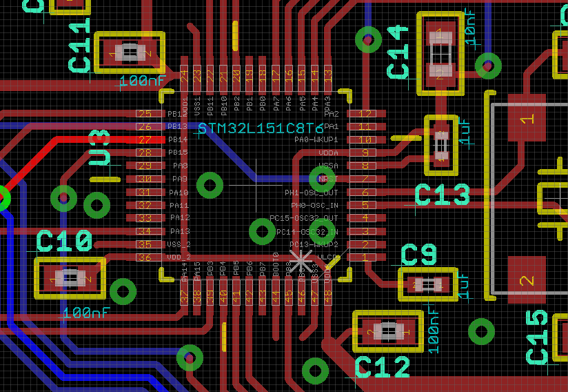

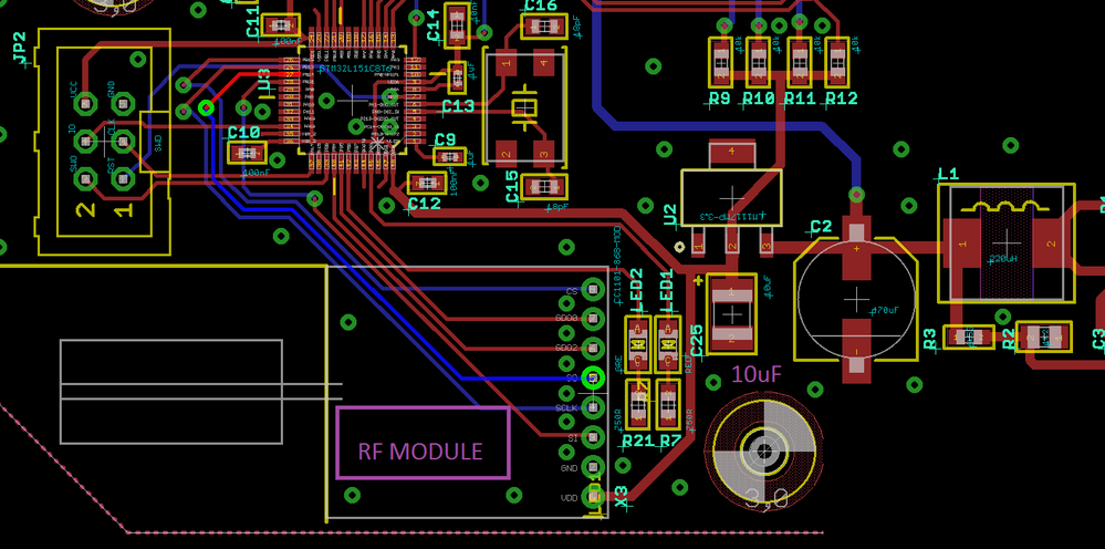

The EXTI Pin settings on my side: GPIO_InitStructure.GPIO_Pin = GPIO_Pin_GD0 ; GPIO_InitStructure.GPIO_Mode = GPIO_Mode_IN; GPIO_InitStructure.GPIO_OType = GPIO_OType_PP; GPIO_InitStructure.GPIO_PuPd = GPIO_PuPd_DOWN; GPIO_Init(GDO_GPIO_PORT, &GPIO_InitStructure);From the Voltage point of view on my scope the EXTI pin is stable at LOW or High, driven by CC1101. No external pullup or pull down resistor.>The extra bit is troubling, I guess you'd want to suspect speed/voltage and prefetch. The prefetch path is one of the critical ones, and low voltages will slow things down, including the flash.> Do you have some bulk capacitance close into the supply pins, along with the decoupling caps? This is from the L1-DISCO, C19 is not a tant, and I might look to get a 1uF or 2.2uF close in on the VDD side, especially if the RF TX pulls a lot of instantaneous current, and you'd want it on the chip side of the inductor/chokeThis is my pcb with capacitances. This is done based on recommendations from STM32L152 Disovery kit (almost the same like your schematic). No bulk capacitance near of VDD pins. I have tried to add 1uF to C12 in parallel with no success. The 10uF tantalum is one inch far from MCU near to LDO. No chokes.2014-01-24 7:59 AM
Do you have an LCD? Is there connectivity here? Illustrated in PURPLE

I have no LCD. I have no the puple connection in my design. But I've tried to connect it by wire + add 1uF directly parallel with C12.2014-01-24 8:16 AM
The Ferrite beads that help mi solve the problem are near to symbol X3 on VDD path to RF module and near to pin PB5.

I've spent hours finding some configuration of capacitors to solve the problem. No success :-(.I've unsoldered and measured capacitance of VDD-GND capacitor on RF module -> 5uF. I found that on the RF module is already placed ferrite bead on VDD path.I've tried add capacitors form 1uF to 4.7uF near to MCU on different places with different combinations. No luck at all.The only way I've found to solve the issue is to add Ferrite bead on VDD path to RF module and on IRQ path from RF module.But still, in every HW configruation is sufficent to init GPIO pin PB6 and everything works perfectly stable.I will probably give up to find the real cause and use the PB6 workaround and ferrite beads.Many thanks to all for advices, namely to Clive1. One question on Clive: Do I need to connect VDD to VLCD pin if I have no LCD connected? Or it is ok to leave the VLCD pin connected to GND via 1uF capacitor (as on the PCB design posted) ?2014-01-25 6:05 AM
You might want to look if you can use PB5 as a timer input, I suspect the EXTI rising/falling is very sensitive to glitches, the TIM input capture should at least permit some filtering. In EXTI mode you could also toggle a GPIO and see if the scope suggests and rapid pulses, or need for debouncing.
You are correct the L152 doesn't need a supply on VLCD, the L151 expects VDD. The L1-DISCO provides a way of bridging, but that looks to be unpopulated. I'm guessing this is a 2-layer board, with grounding on the back, or perhaps 4-layer. I probably would have done a couple of things a bit different. I'd have a top layer ground immediately under the RF module, and not route signals directly under the module. For the 2-layer putting the signal routing on the back, and pulling the routing closer to the pin connector end, away from the antenna, and active portion of the TX circuits/amps. I would have bifurcated the 3V at C25, taking the RF module supply around the right side, and the supply to the STM32 from the left. I would have widened the trace width for the supply under the STM32, and to circuitry beyond it, and reconfigure the VDDA flow wrt to the bulk/decoupling. For 2-layer board power routing tends to be a problem, I tend to think of it like plumbing, the pipes need to be thick by the supply, tapering to the end-points2014-01-25 7:47 AM
2 layer board>I probably would have done a couple of things a bit different.>I'd have a top layer ground immediately under the RF module, and not route signals directly under the module. DONE>For the 2-layer putting the signal routing on the back, and pulling the routing closer to the pin connector end, away from the antenna, and active portion of the TX circuits/amps.DONE>I would have bifurcated the 3V at C25, taking the RF module supply around the right side, and the supply to the STM32 from the left.DONE>I would have widened the trace width for the supply under the STM32, and to circuitry beyond it, and reconfigure the VDDA flow wrt to the bulk/decoupling.DONE>For 2-layer board power routing tends to be a problem, I tend to think of it like plumbing, the pipes need to be thick by the supply, tapering to the end-pointsI've added two ferrite beads for RF VDD and IRQ line as well.I've routed the IRQ to PA1I've added C6 2u2 for VDD route near to VDD.I''ve also removed the crystal because I will run it on HSI.I HOPE the new PCB will be stable and running well :-).Thank you very much for your time and advice.We’re moving the ST Community to a new platform to give you a better and more reliable community experience.
