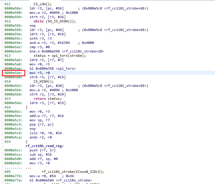

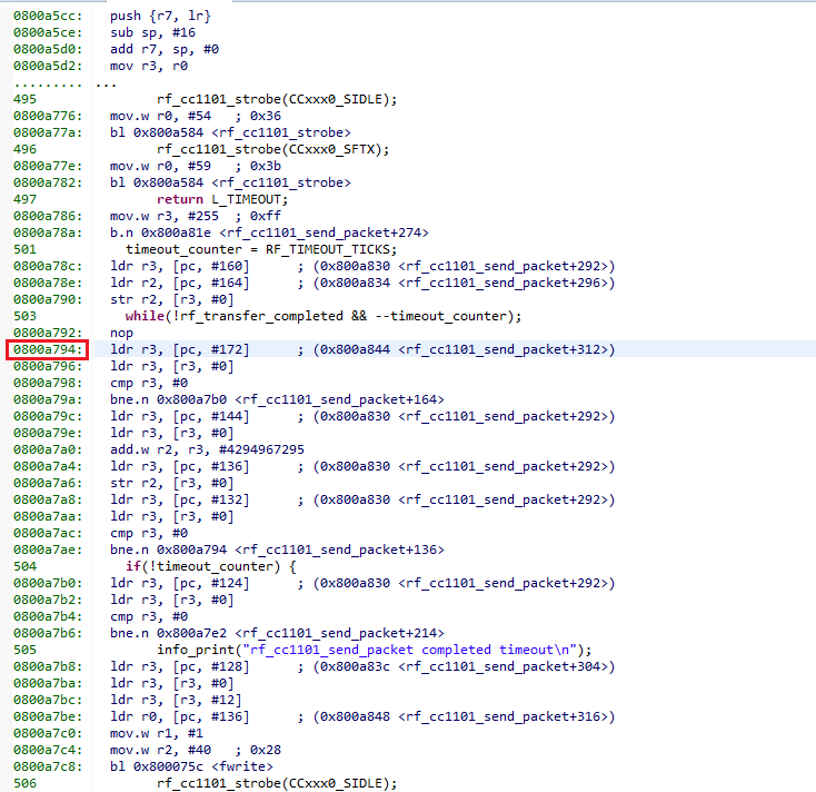

I hope I have the right values:
In Hard Fault HandlerSCB->HFSR = 0x40000000Forced Hard FaultSCB->CFSR = 0x20400Usage fault: Bus fault: r0 = 0xfr1 = 0x20000fbcr2 = 0x20200006r3 = 0x200007acr12 = 0x8lr = 0x800a5afpc = 0x800a794psr = 0x210000002014-01-22 5:57 PM
Yes, that's a bit perplexing, looks to be signalling an INVSTATE

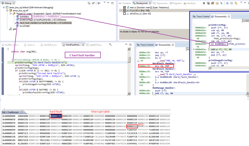

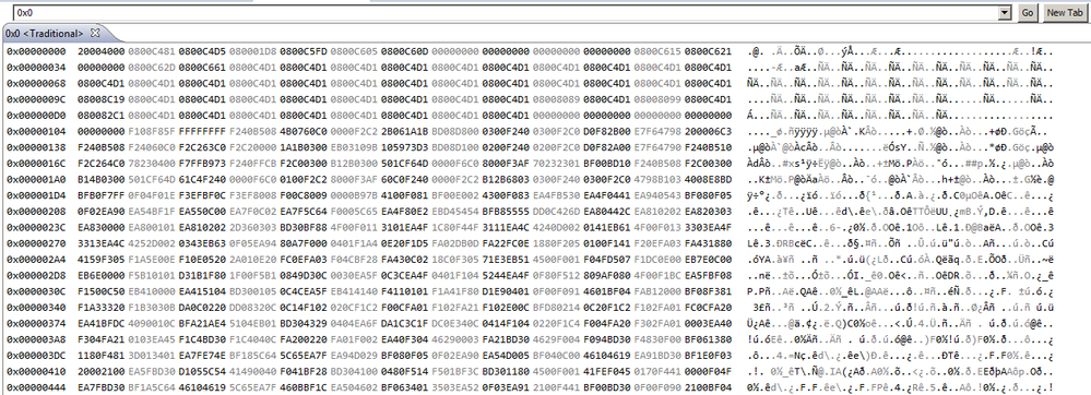

The code also does not appear to be optimized, but does represent the C, although I can't see the literals it's loading. Observe that the address of you Hard Fault Handler in the vector table is EVEN (0x080001D8), this will cause a failure, the entries need to be ODD, indicating THUMB code. I2C1_ER_IRQHandler I2C2_ER_IRQHandler SPI2_IRQHandler2014-01-23 4:21 AM
The code is compiled by gcc 4.7.3 with no optimization -O0>Observe that the address of you Hard Fault Handler in the vector table is EVEN (0x080001D8), this will cause a failure, the entries need to be ODD, indicating THUMB code.Yes, the address was even, so I've wrapped the ASM code to C:extern void Hard_Fault_Handler(uint32_t stack[]);__attribute__ ((naked)) void HardFault_Handler(void){ __asm(''MRS r0, MSP''); __asm(''B Hard_Fault_Handler'');}Now the address of the Hard Fault handler is odd and all other handlers as well, see the next picture, the lowest part.We’re moving the ST Community to a new platform to give you a better and more reliable community experience.
