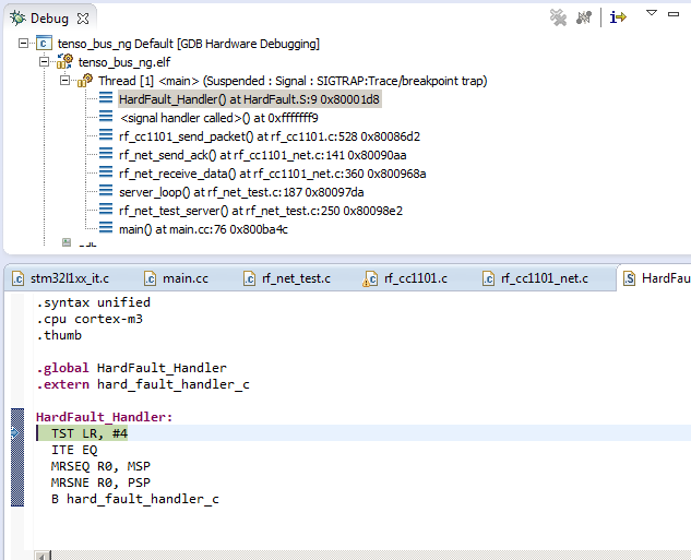

Additional information:
Hard Fault handler routine (see attachment for ASM code) output: [Hard fault handler - all numbers in hex] R0 = 20004000 R1 = 800c405 - ResetHandler R2 = 800c459 - NMIHandler R3 = 80001d8 - HardFault_handler R12 = 800c581 - MemManage_handler LR [R14] = 800c589 subroutine call return address - BusFaultHandler PC [R15] = 800c591 program counter - UsageFault Handler PSR = 0 BFAR = e000edf8 CFSR = 30000 HFSR = 40000000 DFSR = 3 AFSR = 0 SCB_SHCSR= 0 Registers when Hard Fault occurred2014-01-21 5:12 PM

Your Hard Fault handler hex output suggests it's dumping the vector table (at zero), and not register or stack content.
PSP = 0 ?? It would be helpful if you display the other register list in hex, you look at the faulting instructions in assembler, and you hex dump the stack. If it really goes into process mode, as perhaps a result of a corrupted stack return from interrupt, and the stack is pointing at zero, you can surely expect it to fault. So figure out the scope of your stack (0x20004000 .. 0x20003F58), see how deep it really gets, look at what you have as local/auto allocations within normal code, and under interrupt. Fill the stack with a known marker so you can observe the low water mark.2014-01-22 1:14 AM

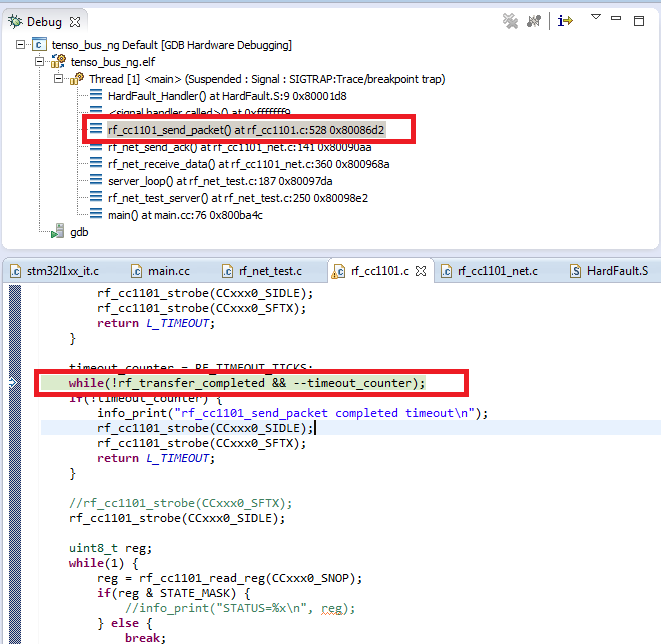

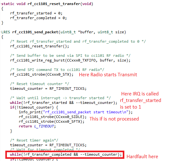

The IRQ handler is very simple.
The problem occurs in routine for sending packets.
I've traced the all instructions in debugger up to the place where Hard fault occured.
No suspicious local variables (only int result codes etc).
No memory operations like memcpy on stack variables.

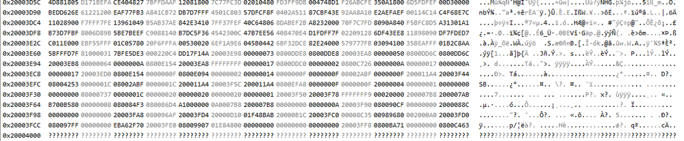

Stack dump after Hard fault

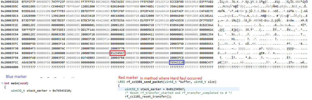

Another run with stack markers

I can't particularly understand why the Hard Fault routine was passed 0, here with an LR entry of 0xFFFFFFF9 it pulls the stack from MSP
Looking at the stack frame as is, we have 0x20 r0 0x20 r1 1 r2 0x20003F50 r3 0x20003F78 r12 0xFFFFFFF9 lr 0x00020000 pc So it looks to be coming from some other interrupt or fault (LR), the PC is invalid (EVEN) Your code itself looks innocuous, even without the disassembly, or knowing if the variables are volatile. The issue is elsewhere. You should examine all your interrupt vector entries, looking for the unfilled ones, or ones containing 0x20000 You should consider what other interrupts or DMA you have enabled, or could be occurring. You want to double check your clock settings, flash wait state and prefetch configuration. You want to see if there is some voltage spike, or short, or GPIO connected with the RF sending/completing.2014-01-22 8:18 AM
