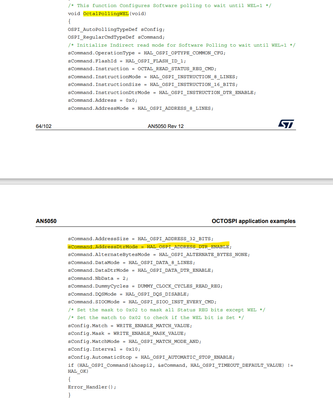

KDJEM.1
Hello @PAV;
First of all thank you for updating post.
The configuration depends on the memory mode selected.
Below is the configuration for the OctalPollingWEL function in AN5050:
Thank you.
Kaouthar

KDJEM.1
Hello @PAV and welcome to the community;
Are you configuring the memory in DTR mode?
In your configuration, you have disabled DTR mode for the address
sCommand.AddressDtrMode = HAL_OSPI_ADDRESS_DTR_DISABLE
I think it should be
sCommand.AddressDtrMode = HAL_OSPI_ADDRESS_DTR_ENABLE
Also, I recommend you to look at STM32CubeU5/Projects/STM32U5x9J-DK/Examples/OSPI/OSPI_NOR_MemoryMapped at main · STMicroelectronics/STM32CubeU5 · GitHub example may help you.
Thank you.
Kaouthar
