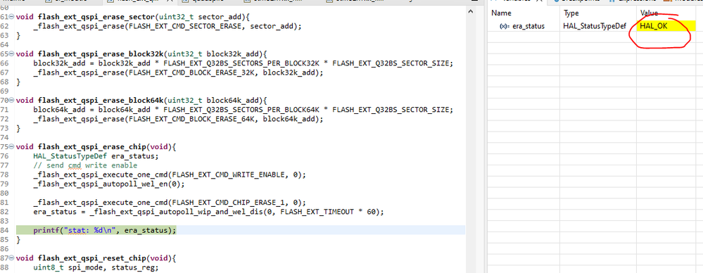

There is not error.
The instruction elapse faster than the polling operation of qspi
polling operation take 7.1seconds but reach printf take less than 1 sec. Timeout is 60sec (FLASH_EXT_TIME_OUT 1000).

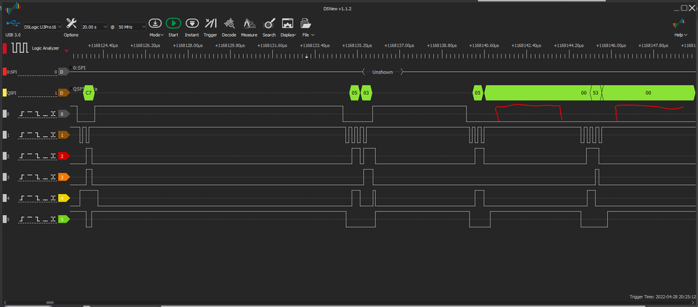

The red marked section (first post) is it retrying, should be able to modulate that width via sConfig/Interval
Why it's not matching is another matter, and may relate to structure initialization. It looks like the code is trying to match something else, or there is some disagreement about modes or patterns.

CLK period is 260ns, so interval is 16 cycles (0x10) which give 4.16us, and the logic analyzer match with this separation between lectures.

The logic analyzer plots look very odd for sure, not sure I have a good explanation yet, but pondering..

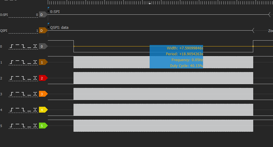

I made many attempts repeating the capture of data with my logics analyzer, because I though maybe CS wire is not attached well, But in all my captures of data, the result is the same graphic (CS not releasing).

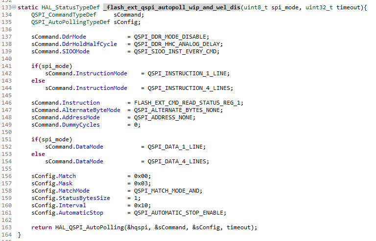

Now, hal_autoplling method wait correctly to the match value (7.1secs).
I change this two lines, from this:
sConfig.Match = 0x00;
sConfig.Mask = 0x01;
sConfig.StatusBytesSize = 1;to this:
sConfig.Match = 0x0000;
sConfig.Mask = 0x0101;
sConfig.StatusBytesSize = 2;Looks like, the minimum size for statusbytesize parameter is 2.
However, my logic analyzer still showing a CS not releasing after first polling.
