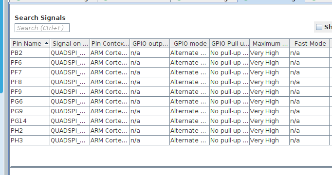

I believe I have figured it out:
CubeMX generates the pin speed for QSPI to low. That doesn't seem to work well on the data lines.
Setting the pins to "Very High" seems to allow for higher QSPI speeds.

Hello @Richard Lowe ,
For the QUADSPI configuration, all GPIO have to be configured in high-speed mode.
I think that the Quad-SPI interface on STM32 microcontrollers and microprocessors application note can help you to check QUADSPI configuration.
This application note describes all QUADSPI configuration steps required to perform either read, write or erase operations such as GPIOs configuration, QUADSPI peripheral configuration and clock.
