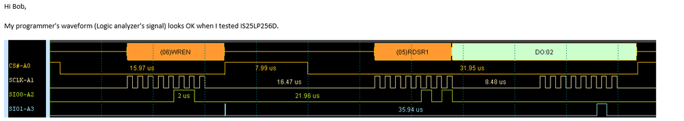

Thanks for the responses. @Tesla DeLorean you are correct 6 dummy clock(cycles), etc doesn't make sense. I'm new to the STM32 HAL library and was hoping I could get some delay after the 0x05 command.
Note, I have the ISSI chip working great with a simple microcontroller on a breadboard. What I need is to understand how to get a STM32H7 to do the same.
Below is a screen shot from the FAE for ISSI who mentioned a 8us delay was needed.

@Bob Shankle
This looks suspicious: no clocks during the 8us delay contradicts to the ST document on QSPI interface.
Such delay is only possible at slower clock rate (more than 8 us between pulses).
Normally, delays are implemented with dummy clock cycles, and number of the cycles is documented.

I agree with you Pavel, but I think the clock pulses during the dummy cycles causes a problem for the ISSI chip.
The "problem" is we can demonstrate how the chip behaves, now to get the STM32 software to support that behavior. (I know it is rewarding bad behavior.)
