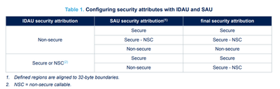

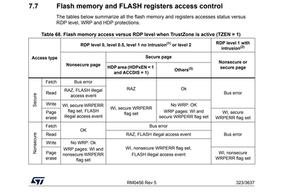

You can refer to the reference manual RM0456, specifically section 7.7 Flash memory and FLASH registers access control, where you will find the explanation of access to the flash memory
and also refer to this application note AN5347, which shows that you have to use NSC register to erase Non -Secure pages.
Thank you.
