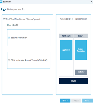

Boot path is configured as follows:

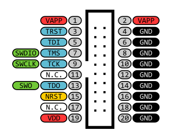

My first guess would be that you didn't connect the reset pin of your target to your STLink V2.
Can you check this?

I checked with our HW team, we haven't connected the reset pin in our ST-Link cable. Only these 4 pins are connected: VAPP, SWDIO, SWCLK and GND.
W/o connecting the reset pin of the target to ST-Link V2, could this be the reason that we failed to write 0xC000000 to SECBOOTADD, or the reason that while doing Debug Authentication, the MCU failed to boot on RSS_DA?
What is the purpoose of the reset pin here?

The reset pin control is necessary for the Debug Authentication procedure. To establish this communication with RSS_DA, the programmer writes a specific value at specific address and reset.
The fact that you see SECBOOTADD to 0 is because you are connected in non secure. In such state you don't have access to all the option bytes even in reading.

Thank you so much. You're amazing! We connected the reset pin to ST-Link cable, RSS_DA access established, and Debug Authentication is successfully done. Much appreciated for your help!
