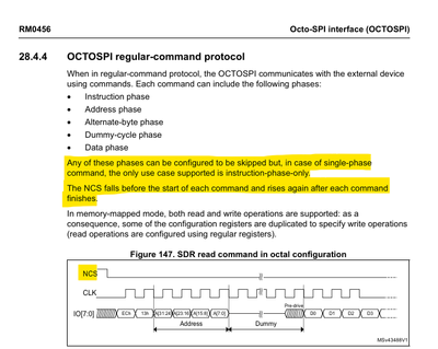

When in regular-command protocol, the OCTOSPI communicates with the external device using commands. Each command can include the following phases:
• Instruction phase
• Address phase
• Alternate-byte phase
• Dummy-cycle phase
• Data phase
Any of these phases can be configured to be skipped but, in case of single-phase command, the only use case supported is instruction-phase-only.

You cannot send only data phase.

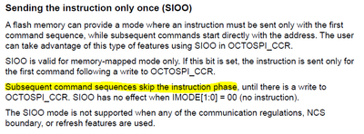

What about if I use the OCTOSPI_CCR.SIOO register to 1, can it make the instruction to be send only at the start of the application with the first send frame and after skip the instruction phase ?

As I mentioned perversely, in case of single-phase command, the only use case supported is instruction-phase-only.
