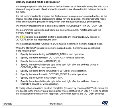

I disabled all caching options (MPU, DCACHE, ICACHE) and the problem still occured at the same location. The OSPI peripheral does have an internal FIFO, perhaps that is playing a role here. The documentation mentions that it is involved in in read operations. Perhaps there is undocumented use of the FIFO for write operations?
Regardless, it seems that even addresses (and even number of bytes) is a requirement for my configuration of dual memory and that is the answer to my original question.
