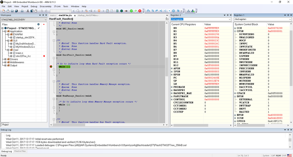

I have created a simple project based on the “STemWin_HelloWorld� example for the STM32746G Discovery Board. I have created two screens with a button on each. The button on each screen loads the other screen, and visa-versa. If you switch back and forth the screens a couple of times the program gets stuck in the “void HardFault_Handler(void)� routine.
From the viewing, the System Control Block Registers with the debugger I can see that the following bits are set.
BusFault Status register
BFSR -> BFARVALID
BFSR -> IMPRECISERR
UsageFault Status register
UFSR -> UNALIGNED
UFSR -> UNDEFINSTR
Different combinations of these bits are set each time you reset the MCU. From reading the manual it appears that a bad instruction is causing the fault but I am unable to narrow down as to where. Can anyone please assist in stopping the program going into the “void HardFault_Handler(void)� routine?

Try using a reasonable Hard Fault Handler and review the faulting instructions and registers. Disassembly view.
Is the stack sufficiently large? Are you corrupting structures on the stack? Review your use of local/auto variables.
If it tries to execute 32-bit ARM code it will fault.

Thank you Clive One.
How do I increase the stack size? Is there a header file with a ♯ define to change?
I can already see the register values from my debugger. But how do I interpret this?

2017-10-11 6:11 AM
Hi ra hummel.
Thank you for your comment. I made the below changes and I no longer get this fault. I will have to consult the IAR manual to better understand the CSTACK and HEAP.
How do you determine what sizes these should be?
