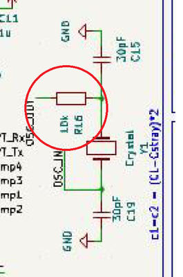

Is this the part of crystal in the schematics?
10kOhm (I think R16) as series resistor? Are you sure?

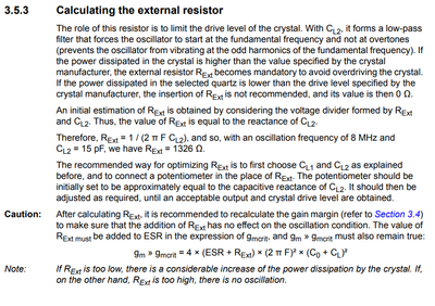

Did you calculate it according to what AN2867 stated?
According to the values in the schematics and what the AN stated:
Rext = 1 / (2 x PI x 48MHz x 30pf) = 110 ohm
So 10K is a very big value.
Then you need to recalculate the gain margin (as stated in the application note).
Also RExt needs to be 0 ohm unless you find the crystal is overdriven:

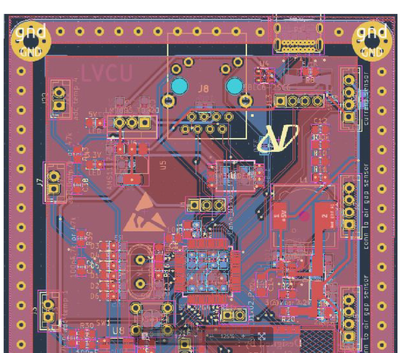

2025-04-08 6:17 AM
This is not the schematic but the PCB layout:

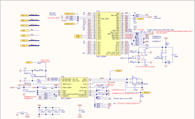

2025-04-08 8:11 AM
2025-04-08 8:16 AM
Sorry I didn't see it.
But the schematics has a very bad resolution. I can't even read the part numbers in the schematics.
Please attach a screenshot of your schematics with a good resolution.
