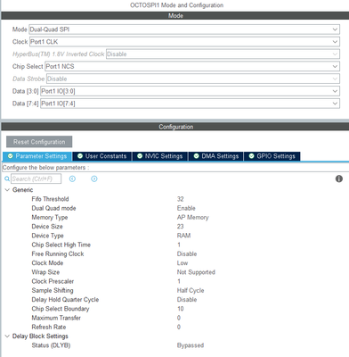

I'm using the STM32U585 with two IS66WVS4M8BLL quad SPI modules. The OctoSPI peripheral is configured in Dual-Quad Mode. See the image for the settings as configured in STM32CubeMX. I use memory mapped mode. I've enabled DQS for writes as per 2.6.1 of the errata. I've tried different MPU cache configurations for this area: no MPU, MPU_DEVICE_nGnRnE, and (MPU_WRITE_THROUGH | MPU_NON_TRANSIENT | MPU_W_ALLOCATE | MPU_R_ALLOCATE).

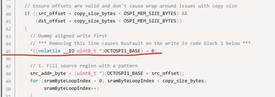

Here's the minimal implementation. Note that 8-bit writes work if the previous write was aligned. See comments surrounded by ***, focussing on Test 2.

// Dummy aligned write first
// *** Removing this line causes BusFault on the write in code block 1 below ***
*((volatile __IO uint8_t *)OCTOSPI1_BASE) = 0;

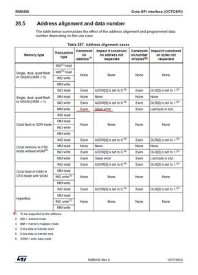

Not sure if this helps.
It seems there are something done wrong on STM32 MCU. befow domments from our team:
1, Since Test 1 is good, basic read/write on dual-quad SPI configuration is working. Effectively, it's OPI with DMM = 1 (dual-memory mode).
2. According to the data alignment constraints, it becomes halfword-addressable memory, not byte-addressable.
3. Test 2 doesn't seem to honor the constraints, as it touches the odd address in the very first PSRAM read. I suspect it is the MCU cache that shadows the unaligned access in Test 1, where the cache is always filled by the previous aligned access. In another words, the cache absorbs the unaligned accesses, such the PSRAM sees no accesses with odd addresses. Once this assumption is broken (as cache is disabled or access an odd-address when cache is cold), there will be unaligned access to PSRAM.
Relevant constraints:
(default write-through) MCU cache is preheated by write:

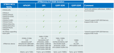

Let me share overview of supported device/SoC
| APMemory IoT RAM Solution | ||||
| STM32 MCU family | HPI/OPI | OPI | QSPI SDR | QSPI DDR |
| STM32L4Rx | - | ✓* | - | - |
| STM32L5 STM32L4P5/Q5 STM32U575/585 STM32H5 | - | ✓ | ✓ | ✓ |
| STM32H7A3/B3 STM32H72x/3x | - | ✓ | ✓* | ✓ |
| STM32U59x/U5Ax, STM32U5Fx/U5Gx STM32H7Rx/Sx STM32N6 | ✓ | ✓ | ✓ | ✓ |
| All STM32 supporting NOR QSPI | - | - | ✓* | - |
| APMemory device | 256Mb~512Mb 1.8V BGA24/WLCSP APS256XXN-OBR/OB9-... APS512XXN-OBR/OB9-… | 64Mb~512Mb 1.8V ~3V BGA24/WLCSP APS6408L-xOBM-... APS12808L-xOBM-BA APS12808O-OBR-WB APS25608N-OBR-BD APS51208N-OBR-BD | 16Mb~128Mb 1.8V ~3V SOP8/USON8/WLCSP APS1604M-xSQR-… APS6404L-xSQR-... APS12808O-SQRH-WA | 128Mb 1.8V WLCSP APS12808O-DQ-WA |
| 20pins, up to 1GB/s | 11pins, up to 400MB/s | 6pins, up to 72MB/s | 7pins, up to 166MB/s |

2025-04-07 8:14 AM

2025-04-09 1:34 AM
Hi @Alex - APMemory ,
Thanks for reaching out to your team. Your description of the problem makes perfect sense. The implication is that I'm also likely loosing data when an odd number of bytes is written.
Another helpful clarification is that it is halfword-addressable memory (I assumed word-addressable would be the solution).
I'll construct an example with caching disabled and see if test 1 then also fails.
