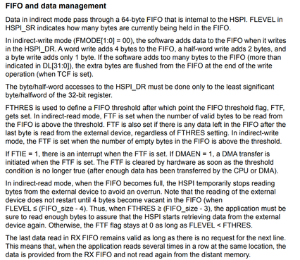

Hello @rdl_42 ,
About the FIFO in indirect-write mode, data written to the HSPI_DR register is stored on the FIFO before it is sent to the external device during the data phase. If the FIFO is too full, a write operation is stalled until the FIFO has enough space to accept the amount of data being written.
In indirect-read mode, reading HSPI_DR register gives (via the FIFO) the data that was received from the external device.
If the FIFO does not have as many bytes as requested by the read operation and if BUSY = 1, the read operation is stalled until enough data is present or until the transfer is complete, whichever happens first.
For more information about the FIFO characterization please take a look at RM0456 section FIFO and data management and to this FAQ.

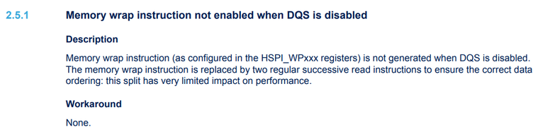

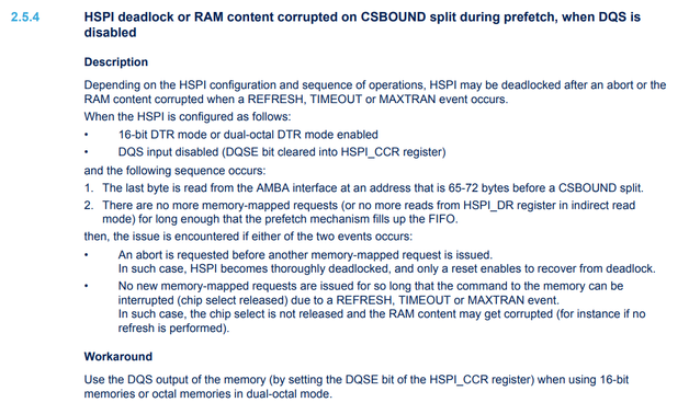

@KDJEM.1 ,
Thanks for the references to errata. I am running with DQS enabled, so I don't think either of these apply. I have continued to adjust register settings, and am now able to read all needed addresses in register space, and read/write the actual device memory in indirect mode.
