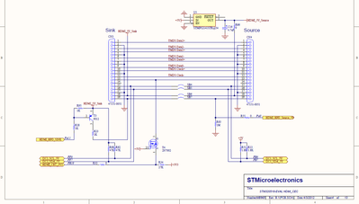

It could be something related to your Hardware. Did you connect a 27k pull-up resistor on the CEC line?
You can refer to the AN4066 "Developing an HDMI-CEC network using an STM32F0xx microcontroller " / Section 2 Hardware environment.
And maybe also to inspire from STM320518-EVAL HDMI-CEC schematics from here:
2024-10-10 3:24 AM

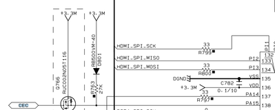

2024-10-14 5:13 PM - edited 2024-10-14 5:31 PM
I had confirmed the circuit for CEC line. Yes, I connected the line with 27k pull up.

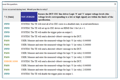

The test is to check CEC line can response correctly withing the limits of the specification.
Test condition:
Connect DUT(Our Product) HDMI out to TE(test equipment) HDMI in. Result are shown as below.
Do you have any idea what is going on. Thank you for the advice in advance.

2024-10-15 6:11 PM
Thank you for this advice.
After discussing with the hardware designer, confirm that the PULL UP method need to be revise.
Problem solved after the rework done to CEC line.
