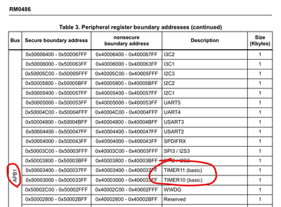

Go to the reference manual in the "Peripheral register boundary addresses" table and you can see which timer is within which APB.

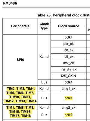

The "timer group clock" is a separate clock you can use to clock individual timers. See timgx_ck below
It's also listed here which PCLK goes with which timer:

I missed that in the "Peripheral register boundary addresses". I guess I do not know what "PClkx" is and where it comes from. I am using STM32CubeMX and am confused on how to set the clocks for the timers. Nothing seems to match with the documentation. What are the "Timer Clock Group" clocks.
