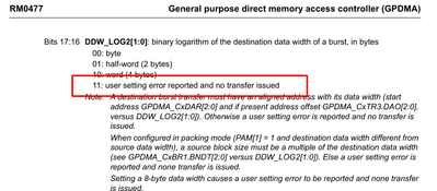

   			|(0b11 << DMA_CTR1_DDW_LOG2_Pos) // the destination is 32 bit aligned

I am not familiar with the GPDMA, but this looks suspicious:
If data packing/unpacking works similarly to the older dual-port DMA, you may want to keep both sides the same width.
