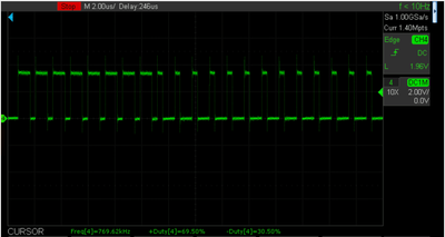

}Everything is normal to me, but this is what my oscilloscope gets:
with zoom (the first 8 bits are high, and the 16 folowing are low, meaning red colour (RGB)):
My problem is that the PWM is random, and never correct.
