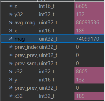

I work on an STM32F407G-DISC1 pedometer project, in which the program is supposed to use built-in lis3dsh accelerometer via SPI to detect and count steps and display the number of steps on the screen (ILI9341 SPI).
I have tested my screen code, and it works properly, so problem lies in how I use accelerometer or detect steps.
To detect steps, I read lis3dsh registers with 100HZ frequency by making a call to SPI from a 100HZ timer interrupt. These snippets are interrupt and timer configuration respectively.

#define CTRL_REG5 0x24I think that the problem is either in step detection logic, or lis3dsh initialization, but I am not sure what the root of the problem is exactly.
UPD: I have accidentally changed the code for the main function in this post to the newer one (I wanted to edit a comment instead)
2026-01-31 2:23 AM
Ok, I have got it working, It still misses some steps, though, but it should be easy to fix. To sum it up, the list of issues my previous versions had:
1) I processed the data in the interrupt instead of the main loop
2) I used to reset the CS pin for the accelerometer immediately after making a call to DMA rather than within DMA interrupt.

I have modified the code. I now get reasonable values from pedometer. I also smooth the input slightly by averaging it with the previous two samples. But it is still wrong. Maybe some constants like PEAK_CUTOFF are off (I approximated it as slightly less than base magnitude squared times 1.2^2, because this source says a step is movement with acceleration ~1.2 g “What Is a Step?” Differences in How a Step Is Detected among Three Popular Activity Monitors That Have Impacted Physical Activity Research - PMC).
These are the approximate values I get when the device is static.
This is the main function

2026-01-31 2:23 AM
3) (last_peak < MAX_PEAK_DIFF) condition prevented the first step from being detected, which prevented the following steps from being detected.
4) In some versions, my constants were off.
5) When I tried to average out three last samples, peaks were prevented from being detected. Replacing it with averaging two samples or no smoothing at all resolves this problem.
Thank you for your help!
