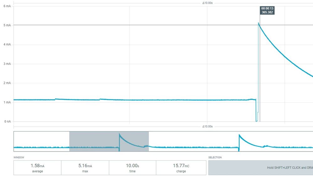

@Saket_Om Your latest post crossed mine. I implemented your solution but still no luck. I do have all the interrupt pending bits (NVIC->ISPR[0 - 15]) cleared now before calling standby, but it still resets. In the post before I thought it stayed in standby, but I was fooled by some test code in the main init code. I measured my current consumption by removing the ferrite on the MCU 3V3 supply line:
It looks like it enters standby shortly, but on the small dip the current is still 130 uA, so it is not fully in standby. I have the following code to stop all peripherals using GPDMA:

With or without debugger attached, it just resets, so the WFI() is aborted for some reason. Can you point me in the right direction?
