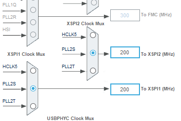

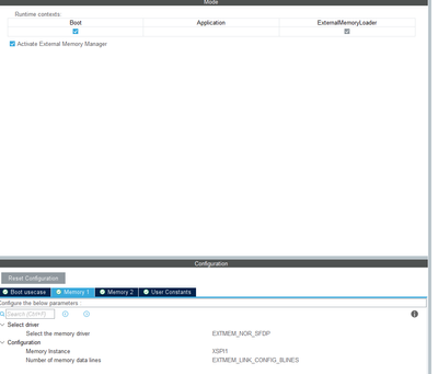

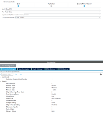

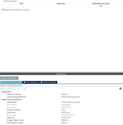

Here the Cube MX settings that i used to make it (SBS also enabled in cube programmer / Cube MX ) and 192kb of DTCM setup
Do you have an Idea to make it work.
