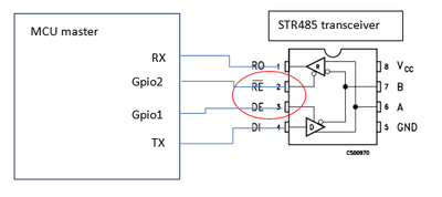

So I have tried to read carefully all of questions/answers of this thread. So you are working with UART5 in RS485 mode but you don't use RTS/DE pin to control your external transceiver, is that correct ?
Instead, you are using 2 distinct GPIO to drive DE and !RE so that you can "decide" if yu want to loopback TX to RX and this is the issue you have that you can retrieve the TX data in your test code, is that correct?
So it could be schematize like this :
If both assumption are correct then I can provide you a code that I have tested with a NUCLEO-H743ZI2 board.
