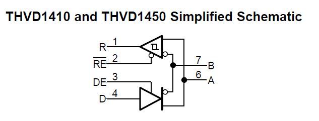

@CharlieMangold In your schematic, you only have a single signal, so TX and RX can't be active at the same time. This is like using UART in one-line mode where a single pin is used for both TX and RX.
Full-duplex 485 transceivers can have both directions active at the same time and has two signals, one for TX and a separate one for RX.

What seems to be missing is your exact setup to fully understand the issue. Are you running a single signal 485? If so the 485 chip(like the one we have) is not going to pay attention to the transmitted data(i.e. the data will be lost.) Your word description implies that there is data coming into the Rx line(via a loopback?) which makes me think you have at least two 485 twisted pairs(two signals.) I'm not a 485 expert but a single 485 signal uses two lines twisted together where each line has the signal inverted from the other line for better noise immunity. How could you send a packet out and get it back because you can't do this with a single 485 signal(take BACnet MS/TP or ModBus for example.) It's hard for me to tell how you have things connected so I'm not much help.
2023-08-25 12:27 PM - edited 2023-08-25 12:42 PM
Because the signal on bus doesn’t have any direction, the receiver in RS485 will send it of course back if RE is enabled. It doesn’t matter who is sending the data. That is why you normally disable the receiver when you send your data so that you won’t receive the sent data. Now I want to read it back to know that my RS485 receiver is working and that there was no collision with other device sending at the same time. The HW I have is like yours. And as I have many times already written, I can see the data on RX line with logic analyzer so HW is working as it should. Only the MCU doesn’t want to see it.

Looking at the simplified schematic of our chip I would not have guessed that the transmitted data would make it back to the receive line. I get that you keep saying that you see data being received but honestly I thought maybe you were mistaken as you showed no O-scope traces(it's hard to tell experience levels here.)
