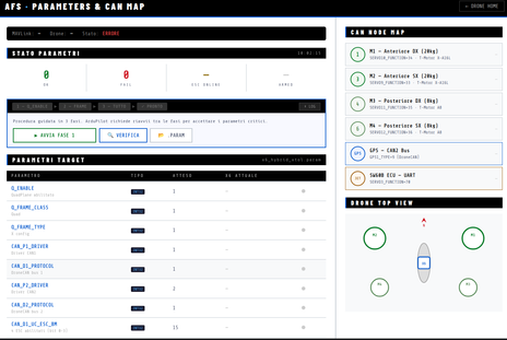

for having an idea...This is the drone/params wizard tool we developed.
Thank you for your help
