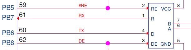

I'm using the UART (USART5) with RS485 and I have enabled the read to be on also when sending. I need to read back the data that was sent to see if it is correct. The problem is, that I do not receive what was sent. But if I send the same data from other device (without changing any code), I will receive the data. So the receive works, but not the same time with sending.

for rs485 yo use a symm driver chip, that has rx/tx switch input - right?
read manual of this rs485 driver chip, usually they switch off rx, when you set it to transmit tx.
2023-08-25 5:30 AM - edited 2023-08-25 5:31 AM
I guess you didn’t read what I wrote. I said that I enabled the read path when sending. I can also see that data on RX-pin with logic analyzer, so the data is there. It just doesn’t end up to FIFO-buffer or to RDR. But if the same data is sent from outside then the data is received.

We use the THVD1410DR 485 chip to interface to our USART. In this setup(there are both Rx and Tx control lines to the chip) you can only Receive or Transmit, not both at the same time. So our driver code will have the Rx on and wait for data to come in. When we want to transmit we will turn off the Rx and turn on the Tx.

We have separate TX/RX enable pins and as I wrote I can see the bytes on RX pin with logic analyzer.

When you say "I said that I enabled the read path when sending", this confuses me. Does your 485 chip allow that? On our 485 interface chip you can only do one direction at a time. So if we enabled the read line(active low) while transmitting, the data would be lost. I did not think 485 interfaces could be synchronous.
