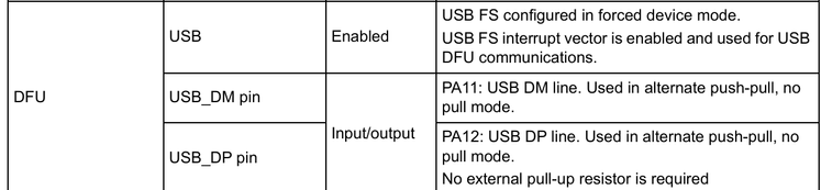

2025-09-18 8:12 AM
Thank you for your response!
I think the key thing I was missing that you pointed out was disabling things that were never enabled. The program counter is now going to 0x1FF0CD4C, which, from my understanding, is the bootloader.
However, I still cannot see the device under the DFU tab of STM32Prog. Do you have any other advice?
The bootloader is v9.1, and Nothing is connected to the board (I do not expect the PB15 thing to be an issue). Does PB15 need to be set in order for it to boot?
Thanks!
