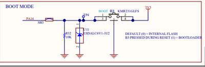

Hello @NotThomasEdison
I attempted to boot the device into the system bootloader using a Nucleo board, and the boot sequence works as expected on my setup.
Please take a look to the schematic of NUCLEO-C071RB

@EThom.3 wrote:
What do you use for setting BOOT0 high? A mechanical switch?
I used the boot mode button which set the pin BOOT0 to high.
I click on boot mode button to set BOOT0 pin high then click on reset button.
