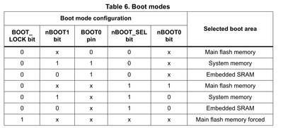

Hello @TWe ,
Are you using STM32U3 or STM32U031?
I you use STM32U031 please look at the RM0503 Rev 4 Table 6. Boot modes and check your configuration.
Thank you.

2026-05-12 1:58 AM
Oh yes, good catch. STM32U031. Sorry for the confusion.
I got to run it now. Somehow the U031 needed a bit more waiting time after power on for the system bootloader to load.
Thanks for your help!
