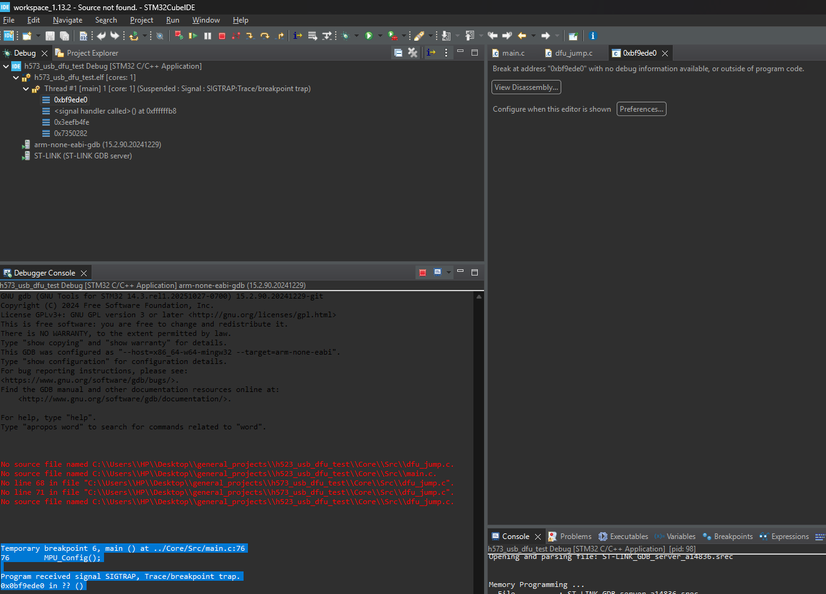

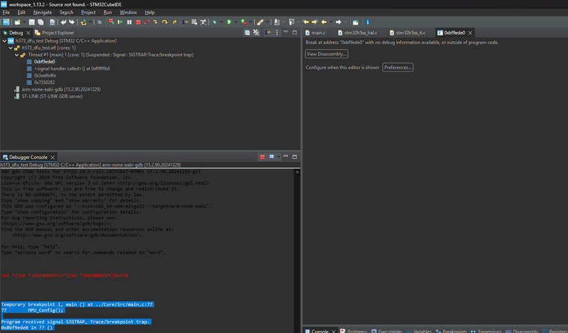

Hi @mƎALLEm, thank you for your reply.
I already checked and tested this code, it didn't work in STM32H573I-DK. same error with my code
'Break at address "0xbf9ede0" with no debug information available, or outside of program code.'
