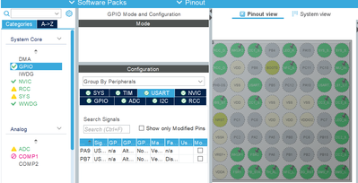

To wich pins is UART1 routed, and what are these pins connected to externally ?
Is UART1 initialized anywhere in your release code ?
I suppose not.
2025-09-23 12:10 AM
I'm using UART1, initialization is done by autogenerated code. MX_USART1_UART_Init();

@chai2145 wrote:found that it actually stuck at while loop.
while (!(huart1.Instance->ISR & USART_ISR_TXE));
So it's waiting for the Transmit register to become empty - and that never happens.
As @Ozone said, are you sure the USART is being enabled?
You haven't said what chip you're using - does it have hardware flow control?
