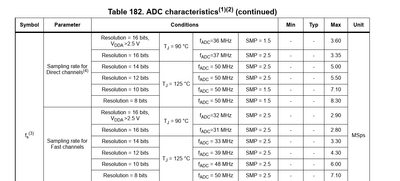

see ds :
So up to 8 msps in 8bit mode possible; with all 3 ADCs interleaved up to 24msps .

see ds :
