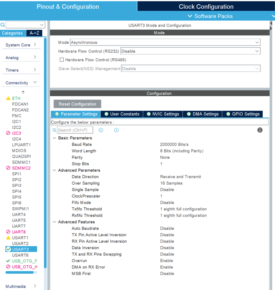

I am using a nucleoH743ZI2 and STM32CubeIDE v1.13.2 on windows10
I configured the USART 3 in order to receive some telecommands from my laptop (windows 10) using a software (HTerm v0.8.9)

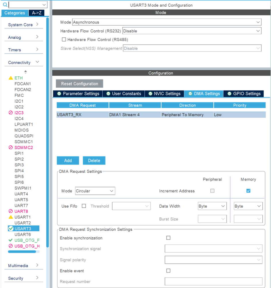

I intialize my callback with DMA:
char UART3_rxBuffer[UART_DMAsize]={0};
HAL_UART_Receive_DMA (&huart3, &(UART3_rxBuffer[0]), (uint16_t) UART_DMAsize);

Why is there a different behavior between flash/reset and start on power ?
How can I force the index to 0, know that the same code will behave differently according how I started the card?
