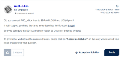

Could you please do the same test with 8-bit access after resoldering the NBL pins? if it's not working, could you please configure SDRAM memory space as device or strongly-ordered?

We want to understand the root cause of the problem.
@sebxx4 wrote:
Btw, how to configure SDRAM memory space as device or strongly-ordered? I don't see such option in MPU config.
You need to set it as not cacheable/not bufferable/ Sharable with TEX level set to 0:

Well, I would prefer to avoid desoldering the circuit again, but I uploaded the previous code and the problem does not occur, so it looks like the cause was a missing connection of one of the NBL signals.
In that case, that's the issue what I was talking about from the beginning.
So need to close this thread by accepting this post:
And open a new one for the SDRAM timing. We need to separate issues in this community.
