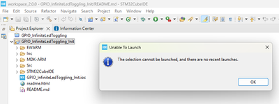

They never said to click Finish to complete the Import Projects dialog. And there is no way to select the project they mention from it. But if I click Finish, then a tiny icon appears on the upper left. If I click it, then there is a Project Explorer window.
The next step is:
My IDE has no Debug icon (the the little yellow blob on its lower left). But it does have a Debug As icon. Clicking that one results in:
So now I'm stuck.

2025-12-10 11:08 AM
"The selection cannot be launched..." refers to the selection in the Project Explorer View. Make sure that the project icon of the project you want to debug is selected.

2025-12-11 7:32 AM
The project was indeed selected.
So it seems that was not the issue.

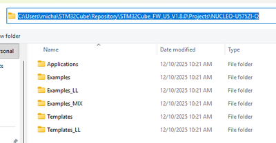

As the installation steps suggest, I got the example from STM32CubeMX:
All the examples then showed up here:
The tools installation steps suggest that one should be able to simply click "Debug" and run the example on the device (assuming driver installation succeeded).

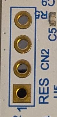

BTW, the instructions say:
But on my board, the CN2 header is not populated:
And there are four leads! What should be jumpered to what?
The board documentation (um2861) makes no mention of it.
Thanks.
Mike

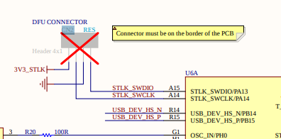

2025-12-11 8:54 AM
right, see circuit of board:
https://www.st.com/resource/en/schematic_pack/mb1549-u575ziq-c05-schematic.pdf
its for programming the st-linl itself - you should never need it.

2026-02-19 7:12 AM - edited 2026-02-19 7:13 AM
Looks like it was purely a 2.0 issue.
Version 1.19 works as expected.
