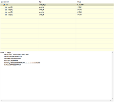

When I do something like this:
*(__IO uint8_t*) 0xC0000000 = 0x01;
*(__IO uint8_t*) 0xC0000001 = 0x02;
*(__IO uint8_t*) 0xC0000002 = 0x03;
*(__IO uint8_t*) 0xC0000003 = 0x04;
uint8_t test[4];
test[0] = *(__IO uint8_t*) 0xC0000000;
test[1] = *(__IO uint8_t*) 0xC0000001;
test[2] = *(__IO uint8_t*) 0xC0000002;
test[3] = *(__IO uint8_t*) 0xC0000003;It works fine:
It looks like some configuration problem. I have "16-bit byte enabled" option enabled, btw.
