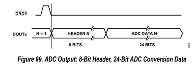

your ADC has data like this (from ds):

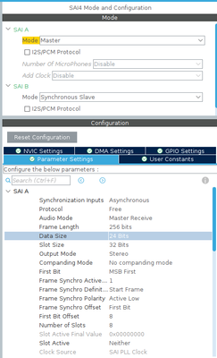

This is not I2S, which is "standard" for audio and also on SAI works fine; you need to select "free" PCM format,
but on this you only could choose 32bit/ch , to get this special format in the SAI slots; maybe like this:
-> for mode 11 on ADC, all 8ch on one data line.
(But i am not sure, this setting is working - i never tried something "strange" like this , so you have to test it yourself. And i will not work on first try - except your very lucky. )
e.g. "frame synchro" lo or hi here the right one - i dont know. (read manuals...or just try...)
