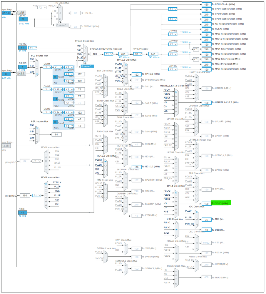

HSE is used, 8 MHz MCO from ST-LINK. It's jitter is roughly 1 ns.
The jitter of the TIM12 output, which triggers the DMA, is ca. 40 ns (!). Maybe I'll have too look at the supply configuration in more detail. The board runs in Supply Config 3 (Internal SMPS and LDO cascaded).
Thats the clock configuration:
2024-01-16 7:14 AM
At least for some other H7s (H723, 725, 733, 735) the 960 MHz after DIVN1 would be too much.
Maybe you are above the limit and CubeMX doesn't recognize it?
For H745 the limit is 960 MHz (from STM32H745xI/G, table 59)
