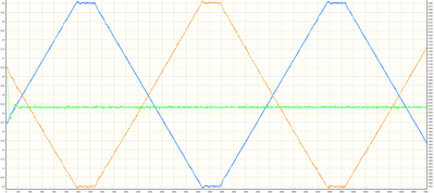

The disturbances are visible in this chart. The orange trace are raw ADC samples, copied directly from the array that the DMA dumps the ADC values in. ADC values are on the right hand axis (decimal). The blue trace is the converted temperature readout, which is where I first noticed the problem.
The disturbing ADC values in this example are 0x073F, 0x07BF, 0x083F and 0x08BF. All ending with the 11111 bit pattern, and exactly 128 ADC counts apart. I have also run tests where the spacing was 64 counts. This also tells me that this isn't random noise.

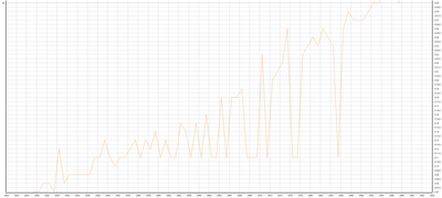

Some zoomed-in examples:
Apparently, it doesn't matter if the temperature is slowly moving up or down:
During other tests, I have observed this behaviour at other values – but always with the xxxx xxx1 1111 pattern in the ADC value. I have watched the sampled values in RAM, by using STM32Programmer through the SWD interface. This is where I first spotted the recurring bit pattern.

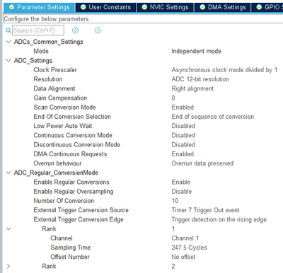

I am unsure about what to show you, regarding setup and code. There is a lot of code in this project. But here is how ADC4 is setup in CubeMX:
Sampling time and offset is the same for all channels.

The result is this, which is a stark contrast to the first graph I uploaded:
