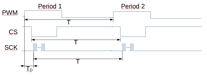

It's about the jitter from one SPI transmission to the next and in relation to a PWM signal. I.e. T and Td in the drawing below must be jitter free (< 5 ns) for all periods.

If jitter have to be under 5ns, then you have to generate all three signals by timers. Master timer should generate PWM and CS signal and (position adjustable) "TRGO" for slave timer. Slave timer should be "advanced one" (TIM1, TIM8) which have "repetition counter" and should run in One-shot mode. When master timer generate TRGO, then slave timer generate burst of SCK periods (defined by repetition counter value) and stops.This way you should be able to generate your pattern. SPI then should work independently as slave and feeded by DMA.
