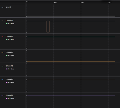

I initially used SPI5, however it wouldn’t transmit anything and its clock was always high.
Then I switched to using SPI2, however it was always stuck low.
Any insight would be appreciated.

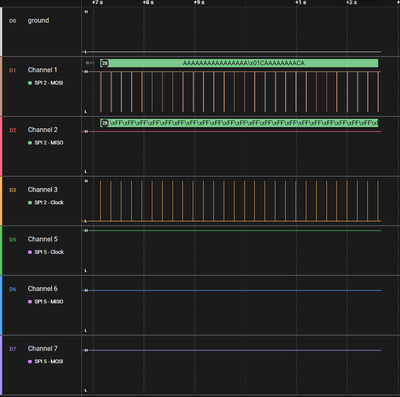

I connected a logic analyzer and here is an image of this :

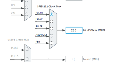

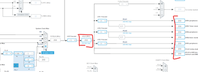

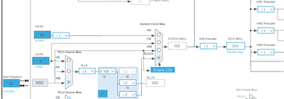

Currently I'm using the default configs for the clock:
the pins I'm using:

2025-01-16 2:19 PM
Read out and check/post content of SPI and relevant GPIO registers.

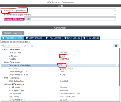

For Future Reference: SPI2 is good to use with this settings and to Avoid using SPI5
