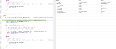

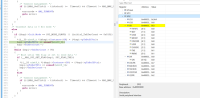

@gbm I have tried capturing variable using debugger after fixing compilation error ,still same issue and found that DR register not updating its value to 0x41

Don't inspect the registers like this, it's invasive, reading DR clears bits in SR. It will also break FIFOs on models that have those.
Also DR is TWO registers at the same address, the data you write in there is NOT the data it reads back.
It's not a MEMORY cell, its a view on a more abstract and complex logic structure, if you looped back the MOSI to MISO you'd need to clock 8 times to see the same data returned on the input side.
Understand that SPI is a symetrical clocked interface, there's ONE clock source, as each bit shifts out and new bit shifts in.

With the version of SPI you use, the debugger can only rarely see the received data in DR. Don't open the debugger SPI register view during any transmission. Look at the values of program variables from variables. Still, you didn't show the updated code.
