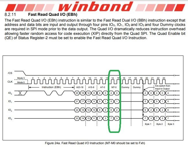

someone can explain me how to calculate the "dummy cycles" number reading an external flash qspi such as the Winbond W25Q64JV ?
I have to read in qspi mode with the Fast Read Quad I/O (EBh) command in SDR mode. The flash memory datasheet asks for 4 dummy cycles between addressing and data available.
In effect, if I set 4 dummy cycles, the first data byte is lost. On the contrary, if I set 6 dummy cycles, the read operation success.
I think this depend to the Pre-drive time, but how can I calculate the effective dummy cycles to apply, to be sure that all the reading will be done correctly ?
Thank you.

It's 6 in your case because you fail to deal with the Mode/Alternate bits that the part is expecting...

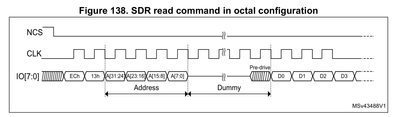

thank you for your answer but in the STM32H5xx reference manual there is this figure about the dummy cycles
As you can see, the Dummy Cycles contains a "Pre-Drive" time that is not described in anywhere, and moreover in the same Reference Manual, speaking about the Dummy Cycle Phase, I found this:
What does it mean "there must be at least one dummy cycle" ....?? Means one, two, three, or so many?
In my opinion, I have to clarify this before ask to the memory manufacturer, because it is not clear.

2023-08-11 8:13 AM
2023-08-11 8:25 AM
you are a genius :grinning_face:
