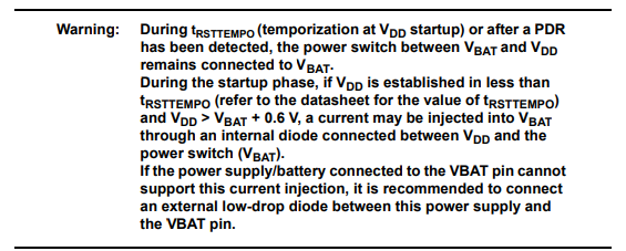

Please note that it is explicitly mentioned in the reference manual RM0444 that is is required to connect VBAT to VDD when no external battery is used:
Important to pay attention to this warning when this condition isn't respected and that may explain the behavior you see:
You have the same in the he AN5096Getting started with STM32G0 Series hardware development.
-Amel
Yes thank you, but I read a few discussions where people say, you can leave VBAT floating in case you don't use anything from VBAT power domain. I just assumed, HSE isn't part of it, so it shouldn't affect it in any way. I hope, VBAT is the real reason behind HSE problems because it is somehow fixable. Though as I said, the fact that in case of battery discharge, HSE could just stop working is a bit worrying.
